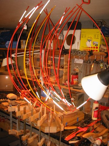

It is really easy.
I just bought a couple pieces of wood and used threaded rods between
them.
My rods are from home depot... Fiberlgass reflector rods with the reflectors
taken off
As you can see from mine, I should have used 2 pieces up top because of
the
deflection by the pressure of the rods
azimmer138864.9918055556

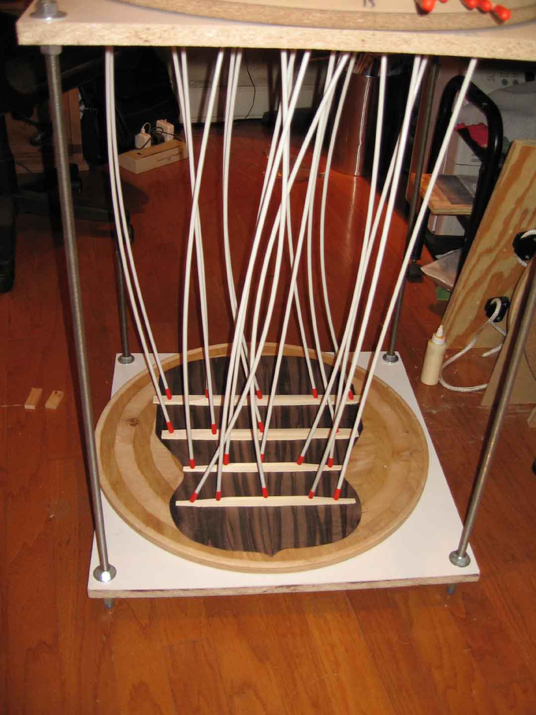

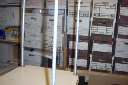

PostPosted: Sat May 27, 2006 4:11 pm
Hi Michael!
Here are a few shots of the construction of my deck, based on the model that Pat Foster showed here, it is very sturdy on both the top and bottom, 2 plates each were glued and 4 --1/2" theaded rods inside tubing and nuts to make it all secure

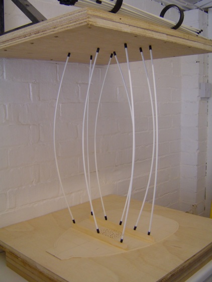

I found on my old one that the two front supports got in the way when glueing on the braces and placing the go-bars. So, I built this one with heavy duty brackets, made from angle iron, which just bolts to the wall, 2 layers of 18mm ply for the top, rods (kite spars) are stored in drainpipe brackets on the top. A moveable platform is used for bracing tops/backs and is taken away for glueing tops and back to the rims.
ColinColin S38865.227650463

I found that by using tubing as spacers between the top and bottom, such as Todd has, and putting them under compression from the nuts, the deck was less wobbly, though strength is not affected. The spacer on the bottom is used when gluing braces and is removed for gluing the top and back.
PostPosted: Sun May 28, 2006 4:15 am
I used 1" metal conduit for my struts, and ran 1/2" all thread through it. The top and bottom are just 1" screwed/glued MDF boards left over from basement renovation, in a 2' square pattern. I used big flat 2" washers to sandwhich the top and bottom, and that's it. The thing is total overkill, and it's so heavy I don't like lifting it...BUT I did it just make sure the deck is sturdy enough handle all the rods. Here's why: The first one I used wasn't sturdy enough to handle the combined pressure of the rods, and I'd get 7 rods in, and the 8th rod would be the one that slightly bent the top and BAM, those prior 7 would go shooting out all over the place. Very, very aggravating.
And I also used the driveway reflectors as go-bar rods. The ones I bought are 48 inches long, and 1.49 each (without tax). There's a store near here with bunches of 'em.
